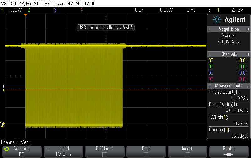

USB-UART Bridge IC Comparison
- Operating systems:
- Linux Kernel 4.4.6, using init (not systemd)
- Windows 7 with drivers from manufacturer's websites
- Settings:
- 3 Mbaud
- 8 data bits
- 1 stop bit
- no parity
- no handshaking
Comparison Table

| MCP2221 |
48.3 ms |
48.3 ms |
46 |
46 |
64 |
64 |
